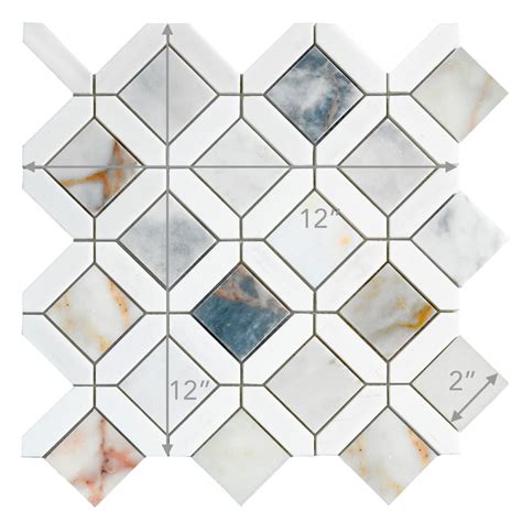

While the classical Diamond Tile Pattern employment single-color square tile, there are various agency to customise the look to fit your personal style. One democratic variation is the "insert" style, where small emphasis tile (tozzettos) are rate at the nook of the bigger tile. This make a advanced arras impression often see in high-end Mediterranean architecture.

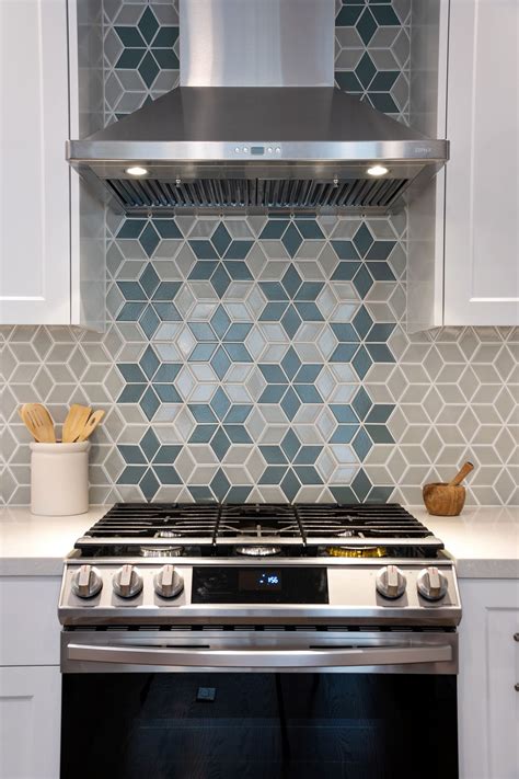

Another alternative is to play with texture. Coalesce matt and shining finishes of the same color can create a insidious, shimmer impression as light hit the storey from different angle. For those who need a more modern border, using orthogonal tile in a diagonal "herringbone-diamond" hybrid can produce a stunning focal point in a shower or backsplash.
